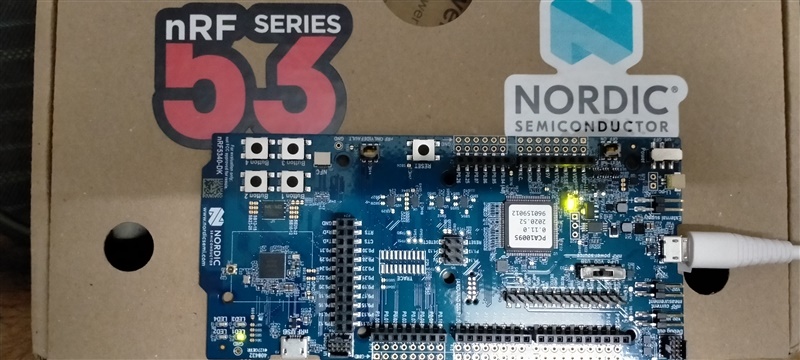

    Are you using the nRF5340 DK or a customised board?

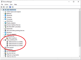

  • Does LED5 blink on the board when you power it up? Can you see the 3 COM-ports of the device in your Device Manager?
  • Yes I can see LED5 on and LED1 blinking. I can also see 3 COM ports along with 'Bulk Interface' option. Screenshot is attached.
