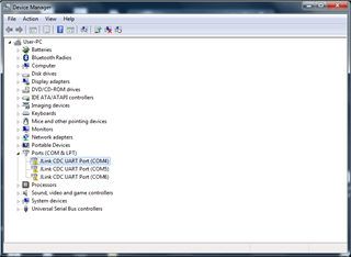

Hello Timothy,
Thanks for the pictures! The 3 COM-ports are supposed to be registered as “JLink CDC UART Port”.
Are you sure that you are using an USB data cable and not one for powering only?

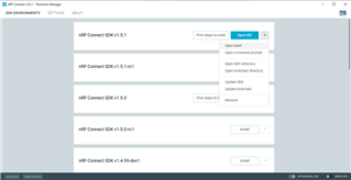

Do you have the Toolchain Manager and a nRF Connect SDK installed? You could open a bash as shown in the picture below
and use the following command:
nrfjprog --version
Do you get a result similar to that?
$ nrfjprog --version nrfjprog version: 10.12.1 JLinkARM.dll version: 6.88a

I can see the same info for nrfjprog. I again reinstalled JLink SEGGER and now I can see 'JLink CDC UART Port' but with yellow flag. I am using windows 7 in this case.
Thanks for the feedback, Timothy!
Unfortunately, we do not have support for Windows 7. Please upgrade to Windows 10.
