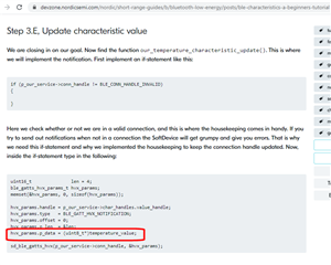

I am getting the values of sensor using add every 1second. and I have stored it in a local variable in saadc callback function.
Now this value that's getting updated how do I pass it to characteristic. The one shown in tutorial is some function regarding inbuilt sensor. In timer timeout handler how do I get the saadc value ?

It really doesn't make any difference where the data comes from - it's all just data.

You mean this:
Yes the tutorial in link. My question is how do i update the saadc value to characteristic. How in step 3F the value gets updated each time temperature changes after calling the function(in the tutorial above). I have my saadc value in saadc call back stored in float variable named val.
Again:
temperature_value there is just a standard C variable - so you just use your variable which has your value in it.
