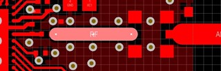

nRF5340 Eval board layout

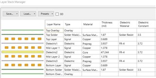

On the Eval board layout, the 2nd and 3rd layer cut away under the RF trace. That make the substract height  equal to 57.87 mil.
For 30 mil width trace, the impedance will be 99.1 ohm.
Is the chip’s RF port designed for 100ohm match, not 50 ohm?
