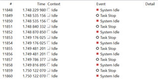

The problem now seems to be more related to Zephyr configuration where the idle task keeps ticking in 264 uS periods, that means every period the RTC is configured to wakeup after 264 uS and sleep again which obviously due to the overhead reduces the low power performance.

And this is a zoom over the first two tests lines 89,90 with 1 ms, hen the test with 250 ms line 98 where we see that the idle task keeps ticking over the sleep and wakeup functions where the debug pins are driven
So my question is, does anyone knows why despite the low power mode config the idle task keeps ticking ?

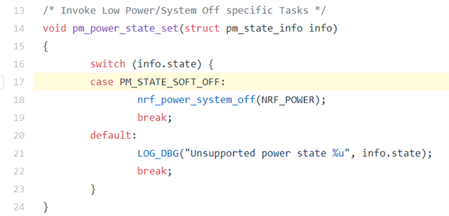

  • I tried that in the first place but it did not work, the current consumption was high, only then I started digging deeper. That's when I realized that the CONFIG_PM had no effect.
    The first issue start in `soc/arm/nordic_nrf/nrf52/power.c` where only `PM_STATE_SOFT_OFF` is implemented.
    https://github.com/zephyrproject-rtos/zephyr/blob/3d39f72a88b3100ac83e7c6c285ae567aca640d0/soc/arm/nordic_nrf/nrf52/power.c#L17
    That means if we call the kernel sleep functions that give back the hand to the OS to keep the idle task running and start tracing back from there you would go through `idle()` task from `zephyr\kernel\idle.c` that only in case `CONFIG_PM` is enabled will call pm_save_idle -> pm_system_suspend -> pm_policy_next_state which then always returns `PM_STATE_ACTIVE`.

    Otherwise, we can also talk about code review, and how the zephyr sleep is supposed to put the nRF52 target in sleep and the resume after waking up from the RTC interrupt. I did implement additional low power states (in the patch link I provided), but due to what seams like a bug, the idle Task does not let go and keeps ticking, it's hard to debug as the RTC behavior cannot be step debugged and the real time pio debug does not output values. And by the way Zephyr OS is using the RTC so the user is not expected to touch it and the system would wakeup on the next expected event. To be more specific, in tickless mode, the system is only expected to wakeup in the next planned event and not keep waking it periodically every 264 uS to check if something has to happen, that is what I'm observing now. That frequent wakeup creates a cpu overhead that deteriorates the average current consumption during the kernel sleep period.
    More obvious with SystemView
    This is how a supposedly low power kernel sleep looks like, idle keeps looping and scheduler keep triggering periodically
