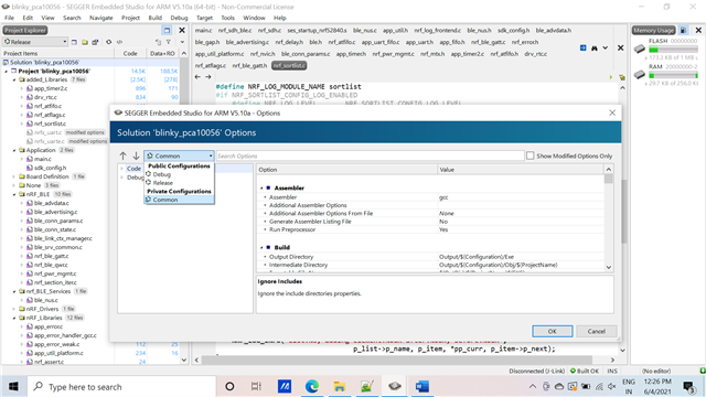

I am using a nRF52840 with "SEGGER Embedded Studio for ARM 5.10a" and "nRF5_SDK_17.0.0_9d13099" sdk.
I have successfully added Bluetooth in my project .
Here is the step by step guide if any one needs it.
Create a folder named nRF_SoftDevices and add these files
Create a folder named nRF_BLE and add these files
Add following files to nrf_Libraries
In the end
Create a folder named nRF_BLE_Services and add the file related to services you need. I need “nus” service so I have added files required for that

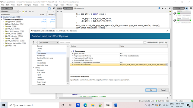

Go to Solution ‘project name’ right click, go to “options” go to “Code” go to “Preprocessor” go to “User Include Directories” and add the paths to the following folders. These are the path of the folders containing “.h” files required to clear the build errors.
For me paths were…
E:\nRF5_SDK_17.0.0_9d13099\nRF5_SDK_17.0.0_9d13099\components\softdevice\s140\headers
E:\nRF5_SDK_17.0.0_9d13099\nRF5_SDK_17.0.0_9d13099\components\softdevice\s140\headers\nrf52
E:\nRF5_SDK_17.0.0_9d13099\nRF5_SDK_17.0.0_9d13099\components\drivers_nrf\nrf_soc_nosd
E:\nRF5_SDK_17.0.0_9d13099\nRF5_SDK_17.0.0_9d13099\components\libraries\timer
E:\nRF5_SDK_17.0.0_9d13099\nRF5_SDK_17.0.0_9d13099\components\libraries\sortlist
E:\nRF5_SDK_17.0.0_9d13099\nRF5_SDK_17.0.0_9d13099\components\libraries\mutex
E:\nRF5_SDK_17.0.0_9d13099\nRF5_SDK_17.0.0_9d13099\components\libraries\atomic_fifo
E:\nRF5_SDK_17.0.0_9d13099\nRF5_SDK_17.0.0_9d13099\components\ble\common
E:\nRF5_SDK_17.0.0_9d13099\nRF5_SDK_17.0.0_9d13099\components\ble\ble_advertising
E:\nRF5_SDK_17.0.0_9d13099\nRF5_SDK_17.0.0_9d13099\components\ble\nrf_ble_gatt
E:\nRF5_SDK_17.0.0_9d13099\nRF5_SDK_17.0.0_9d13099\components\ble\nrf_ble_qwr
E:\nRF5_SDK_17.0.0_9d13099\nRF5_SDK_17.0.0_9d13099\components\ble\ble_services\ble_nus
E:\nRF5_SDK_17.0.0_9d13099\nRF5_SDK_17.0.0_9d13099\components\ble\ble_link_ctx_manager
E:\nRF5_SDK_17.0.0_9d13099\nRF5_SDK_17.0.0_9d13099\components\libraries\pwr_mgmt
E:\nRF5_SDK_17.0.0_9d13099\nRF5_SDK_17.0.0_9d13099\components\softdevice\common E:\nRF5_SDK_17.0.0_9d13099\nRF5_SDK_17.0.0_9d13099\examples\peripheral\Lynkgrid_base_ble\nRF_SoftDevice

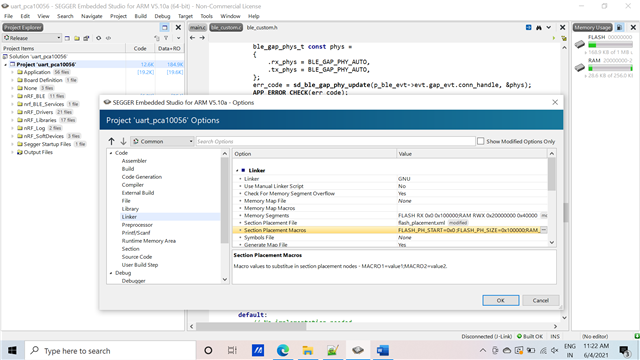

Go to Project‘project name’, right click, go to “options” select “Common” go to “Code” go to “Linker” go to “Section Placement Macros” and set the flash and ram values as given
FLASH_PH_START=0x0
FLASH_PH_SIZE=0x100000
RAM_PH_START=0x20000000
RAM_PH_SIZE=0x40000
FLASH_START=0x27000
FLASH_SIZE=0xd9000
RAM_START=0x20002ae8
RAM_SIZE=0x3d518

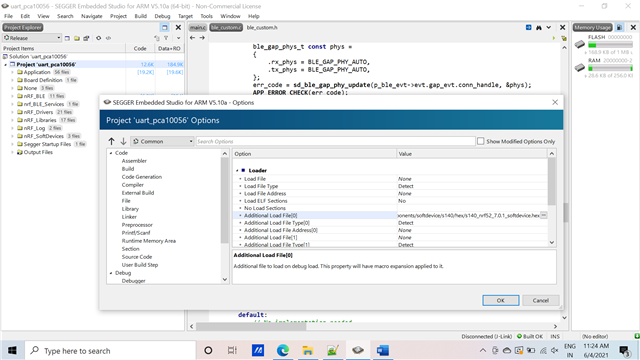

Go to Project‘project name’, right click, go to “options” select “Common” go to “Debug” go to “Loader” go to “Additional Load File[0]” and add the path to softdevice.hex
For me it was…
E:/nRF5_SDK_17.0.0_9d13099/nRF5_SDK_17.0.0_9d13099/components/softdevice/s140/hex/s140_nrf52_7.0.1_softdevice.hex
FLASH_PH_START=0x0
RAM_PH_SIZE=0x40000
FLASH_START=0x27000
FLASH_SIZE=0xd9000
RAM_SIZE=0x3d518
