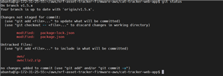

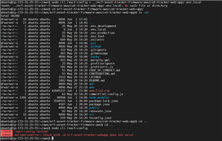

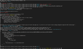

  • Markus,
    I didn't change the package-lock.json. Please have a look at the screenshot attached
  • As I did suspect, the package.json and package-lock.json are modified. Please revert all changes to package-lock.json (it will be modified if running `npm i` (not `npm ci`)), and run `npm ci` again.
    Then try the build step again.
  • Markus,
    I did as you told,
    First, I ran the commands npm I and then npm ci. It is giving me the same error.
  • Please do not run `npm i`.
    Run these commands:
    git checkout -- package-lock.json
    npm ci
