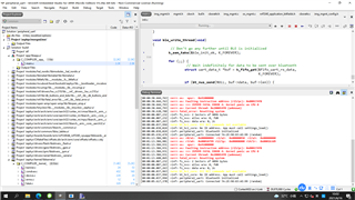

  • zhouhaifang said:
    i place v1.5.1 directly in diak D ,all error like "can not find files"  disappear . I have tested your project . i first load D:\v1.5.1\nrf\samples\bluetooth\peripheral_uart\build\hci_rpmsg\zephyr\merged_CPUNET.hex in nrf5340 net core ,then load merged.hex in nrf5340 app core .run the program ,find that nrf5340 can use BLE  send uart data to app .but when app   send data to nrf5340 through ble ,nrf5340 reset.

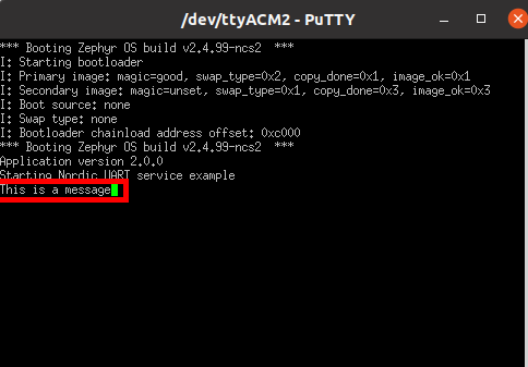

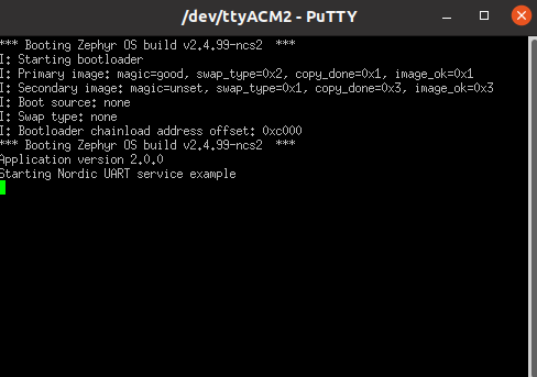

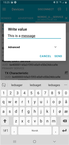

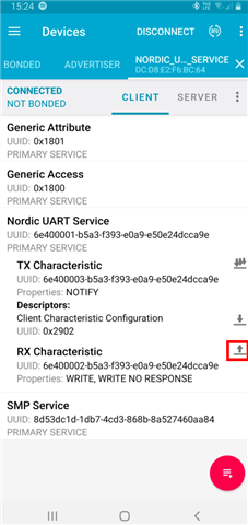

    I was not able to reproduce this. I did the following:
    • Apply the patch to NCS v1.5.1
    • Build and flash the peripheral_uart project
      • west build -b nrf5340dk_nrf5340_cpuapp && west flash
    • Open a putty terminal window and reset the chip
    • Connect to it from the phone and open the RX Characteristic:
    • Then I can see the same message in the terminal, and the chip didn't reset
    Simon
