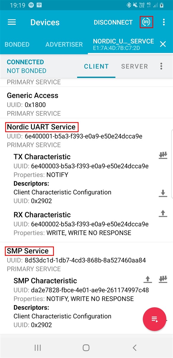

  • You should try to merge the peripheral_uart sample with the smp_svr sample, and create a sample peripheral_uart_smp_svr. Then you will be able to use both the UART service, as well as the SMP service:

  • Can you test the following patch with NCS v1.5.1:
    https://github.com/nrfconnect/sdk-nrf/compare/v1.5.1...simon-iversen:peripheral_uart_dfu
    https://github.com/nrfconnect/sdk-nrf/compare/v1.5.1...simon-iversen:peripheral_uart_dfu.patch
    It will make it possible to perform BLE DFU with the peripheral_uart sample. At least it worked for me:

    *** Booting Zephyr OS build v2.4.99-ncs2  ***
    Application version 1.0.0
    Starting Nordic UART service example
    I: Starting bootloader
    I: Primary image: magic=unset, swap_type=0x1, copy_done=0x3, image_ok=0x3
    I: Secondary image: magic=good, swap_type=0x2, copy_done=0x3, image_ok=0x3
    I: Boot source: none
    I: Swap type: test
    I: Bootloader chainload address offset: 0xc000
    Application version 2.0.0
