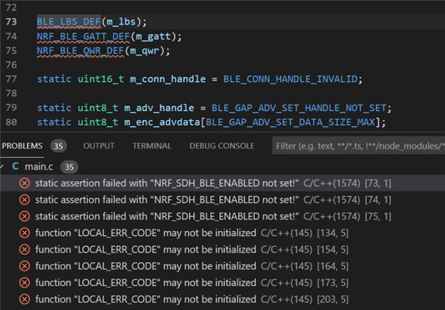

Because you don't have a dongle version of the examples\ble_central\ble_app_blinky_c I am trying to adapt it to work with the dongle pca10059. To do this I have copied over the code from the pca10056 folder. I have adjusted the Makefile and c_cpp_properties.json which tells the compiler where to look for the include files. (I am a bit of a noob with C, but I'm getting there).
So my first problem is that I am getting problems with intellisense telling me that in main.c
90  NRF_BLE_SCAN_DEF(m_scan);
and some other stuff isn't defined.
So if I go to the definition I locate nrf_ble_scan.h   I have referenced this in my include files
However, at about line 137 I am getting a strange error where it is saying it doesn't like a "const"!!!
typedef struct
    ble_gap_scan_params_t const * p_scan_param;
And at this point I'm stuck.
I'm assuming that ble_gap_scan_params_t
 is defined somewhere, but the IDE is telling me that it is defined in 17 out of 20 files. I'm thinking I'm on a lost trail here.

  • So, I seem to be narrowing down on the issue (perhaps).
    If I go to the definition for "params" in the offending line in main.c
    err_code = sd_ble_gap_conn_param_update(p_gap_evt->conn_handle,
                                            &p_gap_evt->params.conn_param_update_request.conn_params);
    I go to ble_gap.h
    However on closer examination and by fluke I noted this was referring to the soft device s112 headers and not s140 which is the sd I need for pca10059. So I think I need to fix how this wrong reference is occurring.
  • Yay O frabjous day! Callooh! Callay! I have slain the Jabberwock!!!
    So, all of these issues resolved down to VS Code deciding to search all kinds of paths looking for include files. I have quite a few projects which I cloned from Github that contained various versions of the nRF sdk rather than one.
    So I removed all my includes from c_cpp_properties.json, removed the unused soft devices from the sdk leaving just s140 and the within VS Code ran the command: "Reset IntelliSense Database"  (Use F1 or ctrl+shift+p).
    Then I slowly re-introduced my include paths ending up with:

    The errors have now all gone and I can get on with trying to understand the code.

  • Spoke too soon, but here is a better list of defines that I grabbed by downloading and installing Segger SES and looking through the pre-processor options
                "defines": [
                    "APP_TIMER_V2",
                    "APP_TIMER_V2_RTC1_ENABLED",

    I have opened another ticket on how to locate the documentation which tells us what defines we should consider as I am not certain this is an exhaustive list, but at least I'm not getting any VS Code "PROBLEMS" with intellisense on any opened files.

    As fare as I am aware, look at the example you want to reference and take a peek at the makefile to see what defines are there.
    Then add the info to the json file in VSC, so that the .json and makfile match
