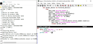

However, it does not succeed. I can know this for certain because the image on the device is not modified to the new package. I can verify this according to the behavior of the device. Thus the command fails. There is no error message to help me diagnose the error.
I am certain that the COM port is correct, please see the screenshot of Windows Device Manager below.
I have set the verbosity to the maximum verbosity (-v -v -v -v). I also tried using the log, which has less output than not using the log.
The same command works on another Windows 10 PC (after adjusting the COM port), so I am certain that the command is valid. Because the command works, I am also certain that the receiving device is working properly. I can determine that the command succeeded based on the behavior of the device. Thus, I am 100% confident that the command is valid and works on another machine.

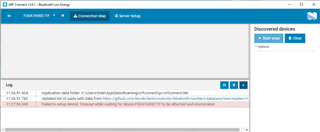

  • Thanks for following up. I tried with NrfConnect, but unfortunately there's a timeout. The log file and a screenshot of NrfConect are attached.
    2021-06-10T18:26:51.604Z INFO Application data folder: C:\Users\REDACTED\AppData\Roaming\nrfconnect\pc-nrfconnect-ble
    2021-06-10T18:26:51.703Z DEBUG App pc-nrfconnect-ble v2.5.1 official
    2021-06-10T18:26:51.703Z DEBUG App path: C:\Users\REDACTED\.nrfconnect-apps\node_modules\pc-nrfconnect-ble
    2021-06-10T18:26:51.703Z DEBUG nRFConnect 3.6.1 is supported by the app (^3.6.0)
    2021-06-10T18:26:51.703Z DEBUG nRFConnect path: C:\Users\REDACTED\AppData\Local\Programs\nrfconnect\resources\app.asar
    2021-06-10T18:26:51.703Z DEBUG HomeDir: C:\Users\REDACTED
    2021-06-10T18:26:51.703Z DEBUG TmpDir: C:\Users\REDACTED\AppData\Local\Temp
    2021-06-10T18:26:51.742Z INFO Updated list of uuids with data from https://github.com/NordicSemiconductor/bluetooth-numbers-database/tree/master/v1
    2021-06-10T18:27:06.048Z ERROR Failed to setup device: Timeout while waiting for device  FD047A90E71F to be attached and enumerated
