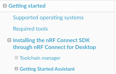

    The layout of where you would normally click, here highlighted:
    These are, atleast in my mind, the path of least resistance when looking at heading/sub-headings.
    By only looking at the left-hand frame, my mind assumes that this is the proper way: "I want to get started, install, and here's an assistant"
    However, that is unfortunately not the simplest way to get started at this time. I'll work together with our technical writers to improve upon this.
