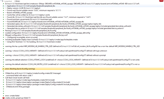

my board: nrf5340dk
os:win10
use toolmanger install ncs1.5.1
my setting
my board: nrf5340dk
os:win10

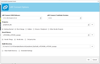

my setting
Hi Kiritro!
Could you try checking the "Clean Build Directory" checkbox?
And I assume you haven't made any changes to the "peripheral_lbs" example project you are starting?
Håkon
I have tried checking "Clean Build Directory" checkbox.
Problems can arise too.
I don't change anything of the project

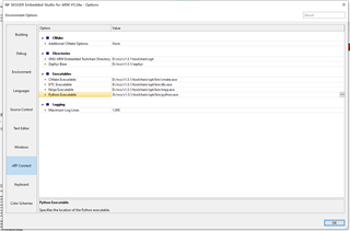

That is weird. I just did a fresh reinstallation of 1.5.1, and my environment paths differ a bit from yours.
So you installed it using the Tool Manager, but did you set any of the Segger Environment Option paths yourself?
Could you try reinstalling NCS v1.5.1?
