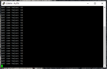

Hi everyone, I'm an intermediate level nRF Connect SDK IDE programmer, and I describe my issue below:
1.- In the link below I found an example of code for the analog port with the nRF5340DK board:
https://devzone.nordicsemi.com/nordic/nrf-connect-sdk-guides/b/getting-started/posts/nrf-connect-sdk-tutorial---part-2-ncs-v1-4-0#h185sjwm5882m1bcimiad82dnf4kcy0b
2.- I removed the PWM code that I'm not interested in, and the main.c file is shown below:

3. The code works fine as shown in the image below:
4. I want to use the "peripheral_uart" example to print the data from the analog port in the serial output, and finally see the data in the Android app "nRF Connect". The example code is found in: ... \ ncs \ v1.5.0 \ nrf \ samples \ bluetooth \ peripheral_uart
and the main.c code is shown below:

  • Congratulations, your solution is elegant and worked ... before closing this discussion, just a small observation.
    This is what I saw in the serial port:
    This is what I saw in the "nRF Connect" App: (Sometimes special characters)
    Sometimes number train
    I assume this is an Android app issue.
  • Hi Guillermo
    Good to hear you got the example working Slight smile
    The Nordic UART service is intended for sending text strings back and forth (ASCII), and when you send raw data from the ADC it will be interpreted as ASCII characters in the Android app.
    In order to display the numbers properly you have to convert it to an ASCII string, either before you pass it to the NUS service in the nRF5 device or after you receive it in the Android app.
    The advantage of converting it on the nRF5 side is that you don't need to change the app, but the drawback is that you will increase the amount of data that you need to send over the Bluetooth connection, which will effectively limit the amount of ADC data that you can send.
    The reason the numbers are readable in the serial terminal is that the printk(..) function does the ASCII conversion for you when you use the %d parameter:
    https://github.com/too1/ncs-peripheral-uart-adc/blob/master/src/main.c#L551
