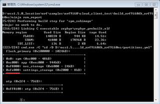

cloud_client uses nvs library to report an error: invalid address: 0x00100ff8:8
I want to use nvs in nrf cloud. A conflict is found between the nrf_cloud library and the nvs library. The nrf_cloud library will cause the nvs library to be unavailable, and an error will be reported: flash_nrf: invalid address: 0x00100ff8:8.
I added nvs library to cloud_client to reproduce this problem. This is my prj.conf:

log:
SPM: NS image at 0xc000
SPM: NS MSP at 0x2001d5a8
SPM: NS reset vector at 0x12e49
SPM: prepare to jump to Non-Secure image.
[15:44:22.555]收←◆*
[15:44:22.579]收←◆** Booting Zephyr OS build v2.4.99-ncs1  ***
I: Cloud client has started
E: invalid address: 0x00100ff8:8
I: 3 Sectors of 4096 bytes
I: alloc wra: 0, ff0
I: data wra: 0, 8
E: invalid address 0x00100ff8:8
I: No binary_state found
E: read nvs error!
E: NVS write binary_state error!
E: write nvs error!
I: Using legacy LTE PCO mode...
[15:44:22.653]收←◆I: Connecting to LTE network, this may take several minutes...
