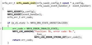

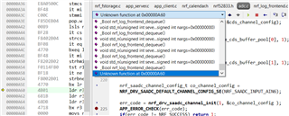

  • Exactly what error occurs?
    it returns 0x08 error , second initializing.
     err_code = nrf_drv_saadc_init(&co_saadc_config, co_saadc_callback);
    Is there any difference between cds_saadc_config and co_saadc_config?
    they are different sensor, so each sensor value needs to sampling.
  • But do they require a different configuration of the SAADC peripheral? If yes, exactly what needs to be different?

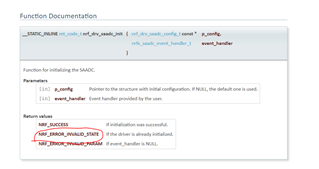

     Yes, as I suspected, the issue is that you try to initialize the driver after it has already been initialized. You need to un initialize it in between if you want to use a different config for the SAADC driver.
    Error 0x08 = NRF_ERROR_INVALID_STATE
