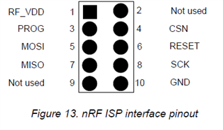

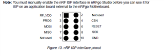

    There is also no indication of what orientation the ISP Port is in. Do you have any way to know? I have tried connecting the pins in either orientation it could be in but neither have worked. This is the only reference I have:

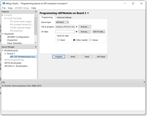

    When I load nRFGo Studio, the motherboard is recognized and there is only an option for ISP programming, shown here:

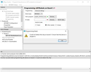

    When I select "Program", this is the error I recieve:

    I would recommend that you ohm from the ISP header on the motherboard to the corresponding pins directly on the nRF24LE1 device to see if they're connected correctly towards the flash-SPI pins on your corresponding package (QFN24/32/48).
    Have you powered the external device? "RF_VDD" does not provide power, its used as a input to the level shifters on the motherboard.
