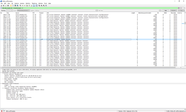

I am using the nordic nRF52840-DK and trying to connect to a nRF52840-Dongle and sending/receiving data to custom services and characteristics using pc_ble_driver_py. I modified the heart rate collector.
But the problem is that when I am connected to the Dongle the connection last 25 to 30 secondes and I receive a message : "Disconnected: 0 BLEHci.remote_user_terminated_connection" and the error message is : "line 477, in write_req attr_handle = self.db_conns[conn_handle].get_char_value_handle(uuid) KeyError: 0". However, when I use the nRF connect mobile/PC version I don't have this problem so I think it is a problem with my code. I check it out if there is some time out equal to like 25_30 secondes but I didn't find any solution.
