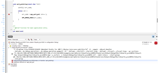

  • I am following this link code but getting the following error.
     * Copyright (c) 2018 - 2020, Nordic Semiconductor ASA
     * All rights reserved.
    /** @file
     * @defgroup libuarte_example_main main.c
     * @ingroup libuarte_example
     * @brief Libuarte Example Application main file.
     * This file contains the source code for a sample application using libuarte.
    #include <stdbool.h>
    #include <stdint.h>
    #include <stdio.h>
    #include "nrf_libuarte_async.h"
    #include "nrf_drv_clock.h"
    #include <bsp.h>
    #include "nrf_log_ctrl.h"
    #include "nrf_queue.h"
    #include "nrf_delay.h"
    #include "nrf_uart.h"
    #include "C:\Nordic\SDK\nRF5SDK17009d13099\nRF5_SDK_17.0.0_9d13099\components\libraries\uart\app_uart.h"
    NRF_LIBUARTE_ASYNC_DEFINE(libuarte, 0, 0, 0, NRF_LIBUARTE_PERIPHERAL_NOT_USED, 255, 3);
    static uint8_t text[] = "UART example started.\r\nLoopback:\r\n";
    static uint8_t text_size = sizeof(text);
    static volatile bool m_loopback_phase;
    typedef struct {
        uint8_t * p_data;
        uint32_t length;
    } buffer_t;
    NRF_QUEUE_DEF(buffer_t, m_buf_queue, 10, NRF_QUEUE_MODE_NO_OVERFLOW);
    void uart_event_handler(void * context, nrf_libuarte_async_evt_t * p_evt)
        nrf_libuarte_async_t * p_libuarte = (nrf_libuarte_async_t *)context;
        ret_code_t ret;
        switch (p_evt->type)
            case NRF_LIBUARTE_ASYNC_EVT_ERROR:
                bsp_board_led_invert(0);
            case NRF_LIBUARTE_ASYNC_EVT_RX_DATA:
                ret = nrf_libuarte_async_tx(p_libuarte,p_evt->data.rxtx.p_data, p_evt->data.rxtx.length);
                if (ret == NRF_ERROR_BUSY)
                    buffer_t buf = {
                        .p_data = p_evt->data.rxtx.p_data,
                        .length = p_evt->data.rxtx.length,
                    ret = nrf_queue_push(&m_buf_queue, &buf);
                    APP_ERROR_CHECK(ret);
                    if(buf.length==2)
                    //    bsp_board_led_invert(1);
                    //    nrf_delay_ms(1000);
                else
               // ret_code_t err_code;
               // err_code = nrf_libuarte_async_tx(&libuarte, text, text_size);
               // APP_ERROR_CHECK(err_code);
                m_loopback_phase = true;
            case NRF_LIBUARTE_ASYNC_EVT_TX_DONE:
                if (m_loopback_phase)
                    nrf_libuarte_async_rx_free(p_libuarte, p_evt->data.rxtx.p_data, p_evt->data.rxtx.length);
                    if (!nrf_queue_is_empty(&m_buf_queue))
                        buffer_t buf;
                        ret = nrf_queue_pop(&m_buf_queue, &buf);
                        UNUSED_RETURN_VALUE(nrf_libuarte_async_tx(p_libuarte, buf.p_data, buf.length));
                bsp_board_led_invert(2);
            default:
    void uart_putstring(const char *str)
           uint32_t err_code;
           while( str )
                err_code = app_uart_put( str++ );
        ret_code_t ret = nrf_drv_clock_init();
        ret_code_t err_code = NRF_LOG_INIT(app_timer_cnt_get);
        nrf_libuarte_async_config_t nrf_libuarte_async_config = {
                .tx_pin     = TX_PIN_NUMBER,
                .rx_pin     = RX_PIN_NUMBER,
                .baudrate   = NRF_UARTE_BAUDRATE_9600,
                .parity     = NRF_UARTE_PARITY_EXCLUDED,
                .hwfc       = NRF_UARTE_HWFC_DISABLED,
                .timeout_us = 100,
                .int_prio   = APP_IRQ_PRIORITY_LOW
        err_code = nrf_libuarte_async_init(&libuarte, &nrf_libuarte_async_config, uart_event_handler, (void *)&libuarte);
        nrf_libuarte_async_enable(&libuarte);
     //   NRF_LOG_INFO("Template example started.");
        uart_putstring((uint8_t*)"AT\r\n");
        while (true)
            NRF_LOG_FLUSH();
    Any suggestion please?
