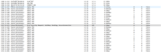

Hello everyone,
1st of all, thank you for taking your time to have a look over my "problem".
I have a device that I am working on, that acts as aperipheral, it is a non NRF one.
I also have a NRF52DK that I am using to develop the central device for my peripheral.

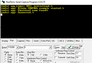

In the central (NRF52DK), for connection, I am scanning for Local Name (shortened local name never works for me).

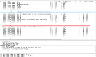

Immediately after a connection is estabilished, from peripheral I issue a BLE_GAP_EVT_SEC_REQUEST, that is visible on the sniffer log, but I seem to get no event in the central device at ble_evt_handler level.
Probably I am completely missing something, but please, can anyone help me out finding out what am I missing?
Thank you in advance,
Victor
  • also, for what is worth mentioning, the PM is not enabled, and I am expecting for the event to show up in ble_evt_handler.
  • Heard such behavior for the first time. Normally a successful security request from the peripheral to central should be visible on the central side as BLE_GAP_EVT_SEC_REQUEST. Can you make s simplistic project for me to be able to replicate  this on my side?
  • well, I am just using the ble_app_blinky_c example for this, and modified it a little bit, just as much as I could test some basic things on my peripheral.

    In order for NRF52DK with this example, to connect to peripheral, the peripheral should advertize the complete Local Name "MQBLG" no matter services and characteristics.
    Immediately after connection request, the peripheral confirms it, and proceeds by requesting security:
    Please let me know if I can offer anything more info in order for you to be able to help somehow.
    I am also having realterm watching on the uart port of NRF52DK and displaying this:
    I would have expected also "security requested" to be printed according to:
           case BLE_GAP_EVT_SEC_REQUEST:
                NRF_LOG_DEBUG("security requested");
                err_code = err_code;
    Please ignore the err_code = err_code; line, it was just a failed attempt to get the optimization out for the line below.
