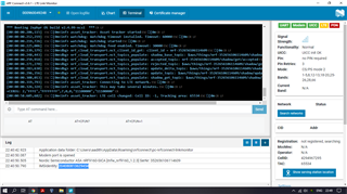

"Error 'AT' timed out".
I've just received a nRF9160 DK.
I've installed nRF Connect v3.6.1 and LTE Link Monitor.
I select the device (3 serial ports are shown). I press reset button and the terminal shows that the application is started.
I introduce AT, AT+CFUN? and AT+CFUN=1 commands but always receive the same message: "Error 'AT' timed out".
What's the problem?
    Can you provide some more information i.e. what sample you are using? What other error do you get? What do you receive in LTE Link Monitor?
    Øyvind
    Please find the log of Programmer and LTE Link apps, I have tried all applications and not seeing debug information as shown in example video
    Please help

  • hi,
    its able to work on AT commands, but the sim is not connecting to LTE network. I am testing this from INDIA, so not knowing whether it works.
    Please suggest

  • Thanks for providing this log. Good to see that you were able to get it running.
    From the log I see you have the correct device, nRF9160-SICA, which supports both LTE-M and NB-IoT. That said, according to GSMA, India does not have LTE-M coverage, only NB-IoT. What SIM are you using to connect? If using iBasis, please try with another local vendor that supports NB-IoT, as I believe iBasis does not support the Indian network yet.
    Øyvind
