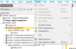

    Just looking through the files that are in the directory for my project files, CMakeCache.txt, cmake_install.cmake, build.ninja, rules.ninja, zephyr_modules.txt, and zephyr_setting.txt files all still reference the old Zephyr path. Based on the .ninja files, these are created by Cmake, but it seems like that creation only occurs when I initially generate the entire project from nRFConnect based on the timestamps that the files were generated, and do not appear to be updated as I make changes to the CMakeLists.txt file (at least with what we have changed thus far).
    The .ninja files explicitly call out to not modify them, but I have to wonder if I need to do something to force update them. More importantly, I don't want to just change the absolute path it points to as that defeats the whole point of my goal to make a relative path to the CMake/project file.
    To add to this, I updated my build.emProject and AppCore.emProject files to use relative paths based on the $(ProjDir) variable which does in fact result in SES being able to find and open the files if I double click on them in the IDE. However, this seems to cause all sorts of problems with the nRFConnect linked in utilities where I can no longer edit the CmakeLists.txt file through the IDE (I get a "Can't open CMakeLists.txt for reading"), the GUI editor for the KConfig file under the project tab is now completely missing (see attached screenshot).
    Reverting the project files back to their original state results in the CMakeLists.txt editing to come back, but the KConfig editor is still missing.
