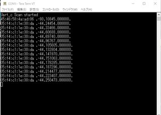

Importing SDK12.3.0 with Segger Embedded Studio does not work.
Motivation: I would like to use SEGGER Embedded Studio V4.10 to use sample projects whose size is not available in keil(no license).
Problem: I can't check the operation of the program (nothing is displayed in TeraTerm), even though the writing seems to be successful. When I write the exact same program from keil, I can see it with TeraTerm.
failure: used segger
success: used keil
I am using SDK12.3.0 and nRF51822.
The evaluation board is EBSGCNZWY by TAIYOYUDEN, and system_nrf51.c is modified according to the specification.
#define __SYSTEM_CLOCK      (32000000UL)     /*!< nRF51 devices use a fixed System Clock Frequency of 16MHz */

I changed the settings of segger by referring to the following link.
https://devzone.nordicsemi.com/f/nordic-q-a/48639/segger-embedded-studio-support-for-nrf5_sdk_12_3_0_d7732ad-this-is-not-a-question/238391
The only differences from the settings are the following.
And "Target Device" is nRF51822xxAC .

The output is shown above.

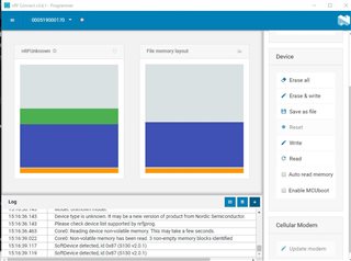

I checked the programmer of nRF connect and it is as follows.
Please give me suggestions for improvement.

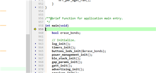

    Have you tried to debug the application to see if the program reaches the main() function?
     __SYSTEM_CLOCK shall still be 16 MHz (the 32MHz signal is divided by 2 internally)
  • I changed the "preprocessor definition" to NRF51822 and BOARD_CUSTOM and changed "custom_board.h" to...\8244.nRF5_SDK12.3.0_SeggerSamples\sdk\nRF5_SDK _12.3.0_d7731ad\components\boards.
  • And you are still not getting anything out on the UART?
  • Yes.
    I checked the debugger, and it enters the running state in the while loop of "app_error.c", and cannot be checked after that.

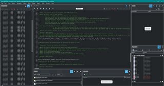

    When I imported it to another PC, I was able to compile it as it was downloaded without adding any settings to the board. Therefore, I think there is a problem with the initial installation of segger on the PC where the problem is occurring.
    The settings are still there after uninstalling and reinstalling, so where should I delete the segger related software?
    In addition, I had tried the following ...
    Other samples were also imported to check the use of segger.
    Also, when I imported other examples from SDK 12.3.0, the error types changed.
    As a further change, while there were many warnings during compilation with app_uart, this time there were no warnings until the relevant part of the error.
    When I did so, an error occurred in the compilation, so I checked the error.
