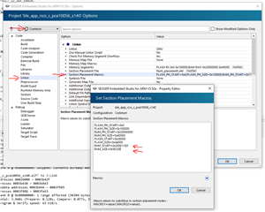

How to read Value if Service 128bit UUID is completely different from Characteristics 128 bit UUID ?
I am able to pair a peripheral device using advertising 16bit UUID to the Central Device(nRF52840-DK board).
Also I am able to read the Battery level service and Device  information service using bas_c_init() and dis_c_inti(). That' Good.
Now device has Some other Custom Primary services with different 128bit service UUID & 128bit Characteristics UUID. See Image Below
To read such values from Unknown Characteristics which function we need to use ?
I am using nRF52840-DK with nRF5_SDK_17.0.2 and S140
  • I have modified below files from the ble_app_rscs_c_pca10056_s140  and SDK Version is 15.3.0

    And what do you mean by debug build target from SES?
    For the ble_lbs_c.c there are no changes from SDK 15.3 except some uncommented cocde. For the ble_lbs_c.h you have modified the UUID and that is the only change in the lbs service implementation, and that does not cause an error.
    When it comes to your main.c file it uses things that are not defined. Where is BLE_UUID_XYLEM_PRES_SERVICE? Here I clearly need a modified SES project that includes the lbs_c service and a sdk_config.h that sets BLE_LBS_C_ENABLED to 1. Please make sure in the future to provide all your changes so that it can be easily reproduced.
    If I fix the above three problems the project builds. Then I test and get an error. However, I always test with the Debug build, as should you. You select the debug build target like this:
    so the error message looks like this:
    <error> app: ERROR 4 [NRF_ERROR_NO_MEM] at C:\Users\eith\SDK\nRF5_SDK_15.3.0_59ac345\examples\ble_central\ble_app_rscs_c\main.c:771
    PC at: 0x00030287
    <error> app: End of error report
    which is much more informative then what you get with the Release build:
    <error> app: Fatal error
    From the error I see that you get NRF_ERROR_NO_MEM at line 771, so that is the return value from ble_lbs_c_init(). This adds a new vendor specific UUID base so it is reasonable to think that the problem is that you need to increase NRF_SDH_BLE_VS_UUID_COUNT from 0 to 1 in sdk_config.h. Do that, and test again.
    Now we get another error, which is expected as the change increased the SoftDevice memory usage:

    So you try to set the app RAM start address a bit higher and reduce the size accordingly, by the approach described in this tutorial:
    After changing the log configuration defines as described under step 8. in the tutorial above, you get this log output:
    <debug> nrf_sdh: State request: 0x00000000
    <debug> nrf_sdh: Notify observer 0x0003B3F8 => ready
    <debug> nrf_sdh: State change: 0x00000000
    <debug> nrf_sdh: State change: 0x00000001
    <warning> nrf_sdh_ble: Insufficient RAM allocated for the SoftDevice.
    <warning> nrf_sdh_ble: Change the RAM start location from 0x20001CD0 to 0x20001CE0.
    <warning> nrf_sdh_ble: Maximum RAM size for application is 0x3E320.
    <error> nrf_sdh_ble: sd_ble_enable() returned NRF_ERROR_NO_MEM.
    401
    PC at: 0x0002FA8F
    This tells us the correct RAM start address and size for the current SoftDevice configuration (after we adjusted NRF_SDH_BLE_VS_UUID_COUNT). Update it like this:
    And now it all works.
    Please note that these are all generic concepts with the nRF5 SDK and SoftDevice, so it makes sense to play a bit with it to understand how the SDK and SoftDevice works. Spending some time on these basics will save you time in the end.
  • Hi Einar,
    You are right about the debug build instead of release build. Appreciate your help and guidance.
    I was able to reproduce all error above you mentioned.
    And after correcting all of them it was connecting to the Custom 128bit UUID service and showing DB_DISCOVERY_COMPLETE.
