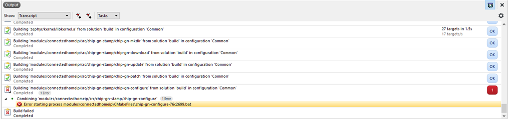

    Thanks for your response. After moving the NCS to a different directory, this issue went away. However, a couple of new errors popped up.
    Error 1: During rebuilding the solution, I'm getting this error:
    Error 2: When I tried to flash (I know I shouldn't flash the solution which isn't building, but just wanted to see if any new errors may come), I got this error:
    How should I move forward?

  • I didn't move anything manually. Using the toolchain manager, I removed the old installation and initiated a fresh installation under a different directory. After that, I opened SES -> Open NCS Project -> And opened the project.
    Do I have to do any configuration before getting these to work?

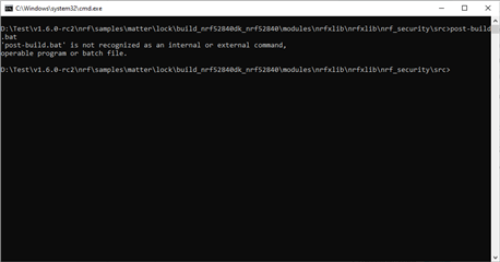

    After doing this, the error changed to: "Error starting process modules\nrfxlib\nrfxlib\nrf_security\src\CMakeFiles\mbedcrypto.dir\post-build.bat".
    I tried running this batch file using the command prompt and was unsuccessful.
    However, opening the same from the file explorer, I could run this file. Although the command prompt, as expected, closed rather quickly before I could take a screenshot.
    I also tried installing NCS in a different laptop and have the exact same error. This answer from DevZone says it may be something related to unsupported characters in the path. However, I couldn't find anything weird in this path: "D:\Test\v1.6.0-rc2\nrf\samples\matter\light_switch\build_nrf52840dk_nrf52840\modules\nrfxlib\nrfxlib\nrf_security\src\CMakeFiles\mbedcrypto.dir"
