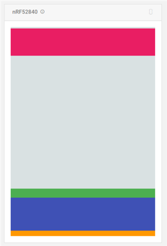

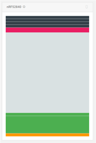

  • In fact the Programmer doesn't know anything about my key does it - it's just a hex file, I guess I have to use nrfutil?
    Flashing the app with nrUtil works in terms of flashing, but the memory layout does not look anything like with the DK
    Here is the dongle (no app flashed because it wont, nor advertise DfuTarg)
    Here is the dk board
    Doesn't look the same. In fact the thin green is ordinary blinky app?

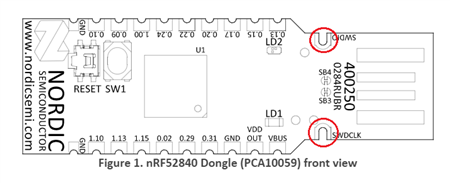

    You can use your nRF52840 DK as the external debugger, by using the debug out connector on the DK as explained here, so you do not need to buy an additional debugger. On the DK you can simply connect a 10-pin cable to P19. There are two connection points for the SWD interface on the backside of the dongle, P1 and J2, but you will unfortunately have to solder. For P1 you only need a standard 2x5-pin header with a 1.27mm pitch, which you can get rather cheap, while for J2 you can use a TC2050 cable from Tag-Connect.
    You also have another option for connecting to the Dongle, which is to connect to SWDIO and SWDCLK directly. This still requires soldering, but you might find this to be easier than soldering the connectors on the backside, and the only things you need in addition to the external debugger (nRF52840 DK) are wires. You can do this by soldering wires directly to SWDIO and SWDCLK on the dongle. I have marked the plated half-holes where you will have to solder the wires on the picture below.
    You can then use P20 as debug out connector on the DK and connect the SWDIO and SWDCLK wires to their corresponding connectors on the DK.
    If you have not already, I recommend reading the section "Using an external debugger" in the guide I linked you earlier before you start programming the dongle using this, as this is where the warnings about the UICR and the voltage on the dongle is important.
