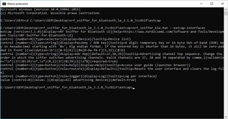

We bought 2 pcs of nRF52840 Dongles and want to use them to test if a nearby BT device has the correct MAC address.
I've programmed them with "sniffer_nrf52840dongle_nrf52840_7cc811f.hex" file and tried to use them according to this instruction https://infocenter.nordicsemi.com/index.jsp?topic=%2Fug_sniffer_ble%2FUG%2Fsniffer_ble%2Finstalling_sniffer.html but devices most of the time does not appear in Wireshark or cmd line. Sometimes after a long time when the PC is running interfaces are recognized but only after reset they disappear.
This is how devices appear in my system. I've tried also to use them with other PC but the same result (sometimes recognized, but most of the time not).
Maybe you could help us with this issue or propose something easier to use to read nearby device MAC address.
