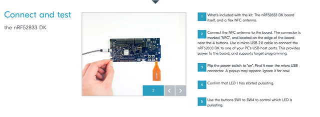

First day using the new dev kit nRF52833-DK. Connected it up following the instructions on nordicsemi.com/start52833dk - computer won't mount the JLINK removable disk so I can't drag the demo HEX file there as per the instructions - any ideas please?

    I can only see one USB port on the nRF52833DK - the one that you are shown to connect to in the instructions on nordicsemi.com/start52833dk - it's step 2 / 3 - see screen shot:
     There are actually two USB ports but the one shown in the image is the correct one.
     The instructions you point to, do not mention this. However, I'm assuming you are pointing to the Getting started with nRF5 SDK tutorial? That said, it is strange that your computer does not register the device correctly. Can you please try to download and install the nRF Connect for Desktop PC application? In this you can install the Programmer app and test to see if your board is registered correctly.
