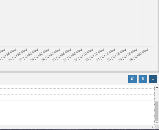

    Is there a way we can directly send the commands to transmit 0 dBm in constant Tx frequency 2440MHz (ch 17) using command line UART raw sequences? Factory team may not use GUI for the automation..
    Any suggestions will be very helpful
    It is very understandable that you want this automated.
    In the lower right corner, you can open up the log file after you have issued a successful command:
    The most left meny here opens the log file.
    This log file shall then hold the raw commands, like this:

    As mentioned, you can also use the radio_test example to setup a constant carrier using uart commands.
