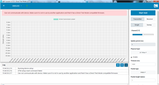

We are trying to get the DTM mode working for the NRF52 2nd BLE for testing BLE TX power and RSSI at the factory.
(1)HW setup is shown
(2) Procedure
We have referred to the link below and the example.py scripts. Below are the steps we have followed before we ran the python scripts
(3)BT module was flashed with the DTM firmware “2020_05_08_BLSD_DTM_CT40_V2.hex” along with serial# and MAC addresses.
Please let us know if we are missing any other step/config to put the device into DTM mode as we are reusing the hex files from another project.
What would be the SDK version that must be used for DTM tests in case we don't have the SDK which was originally used to generate the hex files?
(4)We have run the example.py  script on the PC with the DUT com port field updated to COM41.
We did not observe any UART transactions from PC when scripts were run. HW connections for the COM41 port were verified physically by looping TX to RX and it works fine.

    This is the current profile of the DUT:
    Note that you can also setup your test in nRF connect for desktop -> direct test mode application, and look at the log file to see the raw byte communication going back-and-forth.
    You can also look at the radio_test example in nRF5 SDK to evaluate the RF PHY.

    With those steps, and a properly connected uart interface, you should be able to setup the device in constant carrier with nRF Connect application direct test mode.
    Note that you might have to modify the example if you do not have your uart interface routed via P0.06 and P0.08 (which are the default pins in the board). This modification can be done in direct_test_mode/main.c

    I tried 'direct_test_mode_pca10056.hex' in the path suggested by you from the nRF5_SDK_15.0.0.
    I think the UART pins are not correctly configured in this Hex file as I see no activity on the UART TX line (PC->nRF)
    P1.04 Pin-H1 is the UART TX (out direction)
    P1.07 Pin-G1 is the UART RX (in direction)
    From the main.c
    I can see that we need to configure the UART TX and RX. can you please share an example / hex file with about pins configured as TX and RX?
    static void uart_init(void)
    uint32_t err_code;
    const app_uart_comm_params_t comm_params =
    RX_PIN_NUMBER,
    TX_PIN_NUMBER,
    RTS_PIN_NUMBER,
    CTS_PIN_NUMBER,
    APP_UART_FLOW_CONTROL_DISABLED,
    false,
    DTM_BITRATE
    The init routine reflects what should be written to the PSEL register:
    https://infocenter.nordicsemi.com/topic/ps_nrf52840/uarte.html?cp=4_0_0_5_33_8_25#register.PSEL.RXD
    For P1.04, you should write 32+4 = 36.
    For P1.07, you should write 32+7 = 39.
    Then recompile and flash your board, and try to connect again in the direct test mode PC application.
