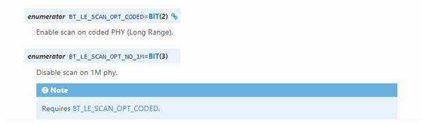

As far as I know, it's fine to scan on coded PHY and 1M. As long as you don't set BT_LE_SCAN_OPT_NO_1M = 1 and only use BT_LE_SCAN_OPT_CODED in the options then you init scanning. It would scan on both. See here.
Have you tried and see any issue ?
