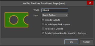

  • Hi Jake,
    I am glad to see it seems like you have resolved the issue. One comment I have is that I recommend you redifine the board outline so it follows the PCB shape. You will find this in Design > Board Shape > Create Primitives from Board Shape.
    Same for the keep-out area. Keepout is not really necessary if you choose "Remove Dead copper" in the Polygon settings and add a design rule call "Board outline Clearance".
    Marjeris

    What are the board outline and keepout areas used for?  When I did the design I just dragged the keepout area so that it matched the outline of the board, but I wasn't sure what it was used for or if there was a more sophisticated way to set them up properly.
  • Hi Jake,
    Sorry for the late reply. Board outline defines the overall extents of the board, while a keepout area can be use to designate areas you don't want to populate with any component or routing.
