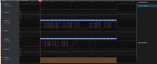

I am using nRF52840 DK and connecting it with SPI to ESP32. The first bit of the transmission is missed for some reason. I could verify that the transmission is ok with logic analyser:

I have checked mode and frequency setting and they all match. Also when I connect two nRFs (one Master and other Slave) they are having no issues when communicating this data.

    It would be nice if you show your SPI configuration code for both sides, LA screenshot with better resolution would also be helpful.
    Thanks for the answer. I dont think that issue is relevant unfortunately, I am not using Arduino but I am using ESP-IDF. Also the essence of the problem is different.
    Why I thought the problem is from the nRF side is because the signal produced by ESP is good and it was verified via digital analyser (I am not sure why the screenshot resolution is not good, once I click on the picture, I can see everything quite clearly - please let me know how to update in even better resolution if necessary)

  • It's hard to see on the picture, but CSN to CLK setup time is obviously too low - about half CLK period. For 52840 it should be at least 1000 ns (see electrical specification for SPIS).
    It seems that software-controlled CS is the only solution for full-duplex mode.
    Edit: oops.. I didn't look at time markers - they show exactly 140 ns CSN-to-CLK time
