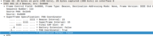

    Darn, we were hoping they would stay in sync. We have two products (ZigBee HA - EPs) released that use the older SDK and were building up a new device (Coordinator) enabled with ZigBee HA to communicate with these EPs. The primary problems we are facing affecting release are:
    1 - The coordinator will accept EP joins regardless of commissioning status. It looks as if this might have been addressed in the ZOI-522 in the NCS. We need the ability to ask our EPs to leave the network in order to have it join another coordinator as needed during deployment. Note that we can ask the EPs to leave and they do so, but immediately join back into the coordinator as an authenticated device outside of the commissioning being enabled.
    nRF5 SDK for Thread and Zigbee v4.0.0 already supports the 'zdo mgmt_leave' command and response, so this sounds strange. Could you send a sniffer trace when this happens? You should double check that you are not starting network steering in the code on the coordinator side after sending the leave message. In the sniffer trace you should look for the field "Association Permit" in the coordinator, if it's set to True the end device will join again after leaving, if it is not set to 'false' look through your code and see if you are starting network steering somewhere in your code.
