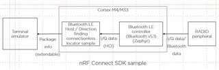

I'd suggest you try the "direction finding connectionless" examples we have available in NCS v1.6. You can find them in the projects drop-down menu in SES, or at nrf/samples/bluetooth. For more info take a look at its documentation.

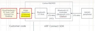

I have run this example i.e connection less transmitter on nr52833 tx. But not getting how IQ sampling is enable on the code so that i can obtain AOA on my receiver side. How will i be able to view and analyse the angle data received ??
If you want something readymade to view the angles, then yeah I can imagine this isn't helping :/

In the meantime, can you see if IQ data is being recieved in the terminal?
