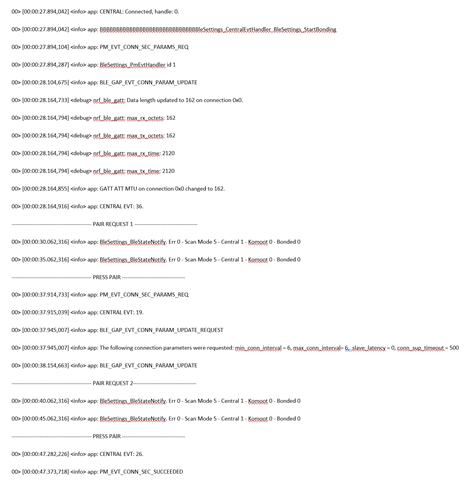

I am testing several phones with a specific App that I connect to my nRF52832. Some phones pair nicely but others do not pair as expected. They display two pairing requests.
- I have checked that my BLE device only sends one pairing request which is the case
- I tried increasing the PM_HANDLER_SEC_DELAY_MS and also setting it to zero but in both cases we would still get two pairing requests
- I allow repairing of already bonded peers
- As described here: https://devzone.nordicsemi.com/f/nordic-q-a/76912/double-pairing-prompt-in-android this behavior might be due to having several services and being peripheral. In my setting the nRF acts as central and connects to the phone which is in peripheral role. Then the phone exposes services as server which the nRF discovers as client. The nRF also exposes services.
What could be the reason we get two pairing requests with some android phones?
When I log the connection trace I get the following messages:

  • That's a great idea!
    I did it and received the wireshark traces that you can see in the appended link.
    I see the following:
    1. my device sends a "Pairing Request (0x01)"   --> first pairing dialogue on smartphone pops up
    2. wait 10s then press the pair button on smartphone ---> I receive "Pairing Response" and send 4 times "Pairing Confirm" ----> at this moment the second pairing dialogue pops up on the phone.
    3. wait 10s then press the second pair button --> get the "Rcv Pairing Confirm", send the "Pairing Random", get the "Rcv Pairing Random"  --> then bonding is done
    So apparently after sending 4 times "Pairing Confirm" we get the second pairing indication on the phone. but it is not clear if its due to this or due to another event in the pairing state machine.

  • Hi
    Thanks a lot for the trace.
    It seems all the encryption operations are taking a lot of time for some reason.
    The delay between the Pairing request and response makes sense, since you need to press the button in the app, but after that I would expect things to speed up.
    Also, the connection settings are quite slow (100ms connection interval, and 4 slave latency), which is why the phone has to retransmit the pairing confirmation for half a second before the peripheral wakes up again.
    Is there any way you could try to use more aggressive connection parameters after connection, to speed up encryption and service discovery?
    It is quite common to start out with ~50ms connection interval and 0 slave latency for the first minute or so, to speed up the initial connection process. Once you are bonded this is no longer needed, since you don't need to redo service discovery.
