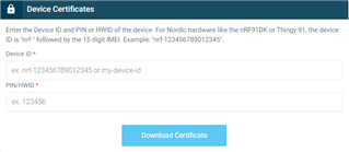

Is there any way to add custom nrf9160 devices to nrf Cloud?
Yes, there is. In nRF Cloud, there is a menu on the top right corner. Click on account. In there you can add a device:
Do not use nrf-IMEI number, as these are already added and specific for our DK and Thingy:91.
Click on Download Certificate to generate certificates for the device with that name.
