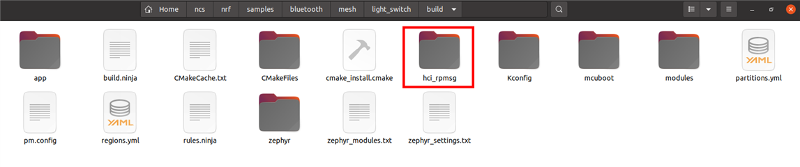

      • If the the two conditions below are met, the hci_rpmsg sample will always be included as a child image (which will make it a multi image build)
        • Using the board name nrf5340dk_nrf5340_cpuapp
        • Bulding a BLE example (e.g. the mesh light_switch sample, or the sample nrf/samples/bluetooth/peripheral_uart)
    4. Then you can see that the sample hci_rpmsg is added as a child image:
    5. And that CONFIG_SECURE_BOOT=y for the network core sample (hci_rpmsg):
