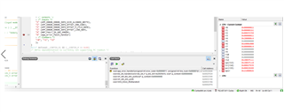

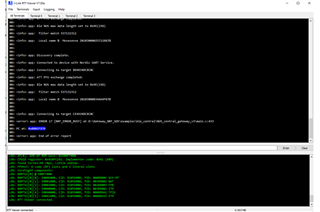

BLE NUS Central using Fanstel BWG840 gateway and 20 peripheral connections using movesense sensors and running S140 soft device
We are trying to create a network using 20 movesense sensors and BWG840 Fanstel gateway acting as the central. The gateway is running a modified ble app uart multilink code from GitHub for connecting to the sensors. While developing and testing using the setup, we came across few odd behaviors. It would be great if someone can help us in figuring out the same.
  1. If the peripherals are advertising before the gateway starts running, the gateway code crashes with a fatal error. The code hits the NRF_BREAKPOINT_COND and halts. Is this expected? Is there any workaround for this behavior?
  2. If the peripherals are being turned on one by one, the code works perfectly. We can connect to these sensors and control them as per our use case. Is there any mandatory requirement like sensors have to be turned on in a sequential manner?
  3. Do we need to make some modifications in the connection interval and timing as we increase the sensor count?
  4. When we increase the sensor count to 19 in sdk_config.h using the macros mentioned below
    // <o> NRF_SDH_BLE_PERIPHERAL_LINK_COUNT - Maximum number of peripheral links.
    #ifndef NRF_SDH_BLE_PERIPHERAL_LINK_COUNT
    #define NRF_SDH_BLE_PERIPHERAL_LINK_COUNT 0
    // <o> NRF_SDH_BLE_CENTRAL_LINK_COUNT - Maximum number of central links.
    #ifndef NRF_SDH_BLE_CENTRAL_LINK_COUNT
    #define NRF_SDH_BLE_CENTRAL_LINK_COUNT 19
    // <o> NRF_SDH_BLE_TOTAL_LINK_COUNT - Total link count.
    // <i> Maximum number of total concurrent connections using the default configuration.
    #ifndef NRF_SDH_BLE_TOTAL_LINK_COUNT
    #define NRF_SDH_BLE_TOTAL_LINK_COUNT 19
    Code fails with error message nrf_sdh_ble: sd_ble_enable() returned nrf_error_no_mem. But the RAM start address was modified in the linker script to the value shown in the log message. But still, this message comes? Is 18 sensors the maximum possible?
We have attached the code and images we have captured using the setup

    We ported the project to SES and this is what we found when there are multiple devices advertising. Is there any workaround for this?
  • Hi again
    I assume line 433 in your main.c is still the APP_ERROR_CHECK for ble_db_discovery_start() as it is in the file of your initial question, right? This check returning NRF_ERROR_BUSY indicates that discovery is already in progress, and the device tries to do discovery again. During the previous connection you can see a "Discovery complete" message before trying to connect to another device. So it seems your application is trying to connect to a new device before the discovery is complete for the previous one. You can try adding a check that a discovery is not running or has been completed successfully before you start scanning again.
    Simon
