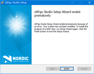

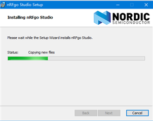

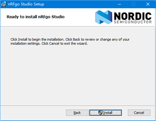

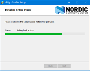

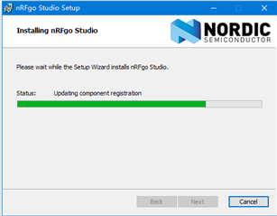

Can't reinstall nrfgoStudiowin641212 after unload
    Note that nrfgo studio is not recommended for new development, and is replaced by nrf connect for desktop.
    I am unable to recreate this scenario when testing on windows 10 x64.
    Q1: Are you choosing a custom/full/typical installation?
    Q2: which operating system version are you running?
    Q3: Do you require nrfgo studio for a specific task?
    Håkon
  • A1: I have tryed all of custom/full/typical installation. but not work.
    A2:windows 10 x64
    A3:nrfgo studio only used for erase chip. a new chip have softdevice inside and protected by default, Can't be erased or programed by IAR and Keil. it must be "Erase All" in nrfgo studio before use. a few days ago, I don not realize this point, I think nrfgo studio is useless and uninstalled it. Can't reinstall Anymore.
    “nrf connect for desktop” is OK. I will choose it and  no longer try to install nrfgo studio.
    Thanks for your reply .
