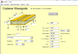

  • Okay, thanks for all the help!  I implemented all your other suggestions, but using the appCAD tool you suggested I wasn't sure what some of the parameters were referring to, I input what I thought was correct but received an error.
    I assumed:
    H: Height of dielectric layer
    W: Width of antenna trace
    L: Length of antenna trace, which I counted as starting from L1
    G: Distance between trace and GND (the top polygon)
    T: Says conductor thickness but I wasn't sure what this was referring to
    What mistakes have I made here?
  • Hi Jake.
    H, W, G is correct.
    T is the thickness of the copper on the PCB. For 0.5oz copper the thickness is ~17.5um/0.7mils, 1oz it is ~35um/1.4mils and for 2oz it is ~70um/2.8mils.
    The length L is not important for calculating the impedance of the line, as long as this not zero it does not affect the impedance calculation.
    The substrate must be change from free space to FR-4.
