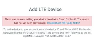

I am stuck on the step of getting the Thingy91 to start working.
I am following this tutorial: https://www.nordicsemi.com/Products/Development-hardware/Nordic-Thingy-91/GetStarted
I uploaded the Modem firmware with the nRF programmer, followed by the MCU firmware. However, no LED lights are turning on for the Thingy91
I tried to go back to upload the modem firmware again, but when I press the modem's button and turn the device on, I can't find the device, and I am unable to reflash the modem's firmware. The device does not appear on the programmer.
I'm not sure how to proceed from this step.
nRF52 firmware: thingy91_asset_tracker_ltem_2021-06-28_7a076c22.hex
modem firmware: mfw_nrf9160_1.3.0.zip
Thank you

  • Hello Markus, thanks for sticking with this so far!
    I just got a new SIM card from iBasis and starting from the point we left off the last time, I stuck the SIM card in and it... worked.
    iBasis said that the card was deactivated because it was not used in a long time - my package indicates that it was made in 2020. Perhaps it would be useful to put a note in the Getting Started page so that people know to ask for a new iBasis SIM card.
