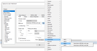

I have successfully installed nRF Connect, nRF Connect SDK v1.6.0 and SEGGER Embedded Studio (SES) v5.50.c to run and debug some samples on my nRF5340 Development Kit. The experience with SES has not been bad at all (projects are ready to go - no configuration needed!). However, I would like to know if there are any alternatives.
I usually work with IAR, which includes the controllers of the nRF53 as target device. Unfortunately, I do not really know how to port or configure any of the nRF samples (e.g. blinky project).
As previously discussed here, I understand that the previous SDK (nRF5 SDK) included IAR support and it was pretty straightforward to use IAR as the default IDE. I wonder if there have been any updates regarding the use of IAR for projects that use nRF53 and nRF Connect SDK.
If IAR were not a viable option, does anybody know of any alternative IDE (e.g.Visual Studio Code, Eclipse)?
