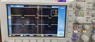

PWM flip output?
I am Working on the nRF52840 custom board.
To drive the motor and buzzer I am using a PWM driver in that when I set duty-cycle 20 percent then the output of PWM shows flip (means 80 percent).
So, what are the issues with PWM? why I am getting flip output on PWM pins?
Here I am sharing my configuration.

I was also trying to inverted PWM pins,
Hare my configuration,
        .output_pins =
            LED_1 ,//| NRF_DRV_PWM_PIN_INVERTED, // channel 0
            LED_2 ,//| NRF_DRV_PWM_PIN_INVERTED, // channel 1
            LED_3 | NRF_DRV_PWM_PIN_INVERTED, // channel 2
            LED_4 | NRF_DRV_PWM_PIN_INVERTED  // channel 3
Output on LED1 ( Yellow ), LED3 ( Blue).
