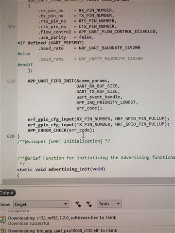

  • Hi Jonathan, I just make some progress today for the project. I found that the hardware of my board with the NRF52 DK board is on the UART port. The UART port of the nRF52832 of the DK board is connected to the debug MCU while my UART port of the MCU is floating and not connected to any other chip. I searched online and someone said should configure the RX pin of the UART port to be pullup after UART initialization. I make the correction as follows.

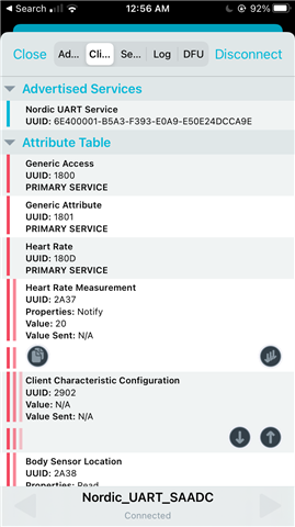

    The firmware worked better than before. I can get the BLE advertising on iPhone through the nRF connection. But the service of the BLE seems different from the normal one shown below.

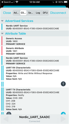

    The left one is the normal NUS service and the right one is the abnormal one. The service seems different. Which code should I correct to make the NUS service works well?

    From the phone screen shoot it looks like you changed to heart rate in stead of Nordic UART service.
