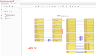

// <o> NRF_PWR_MGMT_SLEEP_DEBUG_PIN  - Pin number
// <0=> 0 (P0.0)
// <1=> 1 (P0.1)
// <2=> 2 (P0.2)
// <3=> 3 (P0.3)
// <4=> 4 (P0.4)
// <5=> 5 (P0.5)
// <6=> 6 (P0.6)
// <7=> 7 (P0.7)
// <8=> 8 (P0.8)
// <9=> 9 (P0.9)
// <10=> 10 (P0.10)
// <11=> 11 (P0.11)
// <12=> 12 (P0.12)
// <13=> 13 (P0.13)
// <14=> 14 (P0.14)
// <15=> 15 (P0.15)
// <16=> 16 (P0.16)
// <17=> 17 (P0.17)
// <18=> 18 (P0.18)
// <19=> 19 (P0.19)
// <20=> 20 (P0.20)
// <21=> 21 (P0.21)
// <22=> 22 (P0.22)
// <23=> 23 (P0.23)
// <24=> 24 (P0.24)
// <25=> 25 (P0.25)
// <26=> 26 (P0.26)
// <27=> 27 (P0.27)
// <28=> 28 (P0.28)
// <29=> 29 (P0.29)
// <30=> 30 (P0.30)
// <31=> 31 (P0.31)
// <4294967295=> Not connected
// We could select the debug pin = LED pin to debug (i.e. display) the sleep mode ON/OFF (For nRF52 DK, LED1/2/3/4 coresponds to P0.17/18/19/20)
// Since the LEDs on nRF52DK are active low, that means the LED will be turned ON when CPU is active. LED will be OFF when CPU is asleep.
#ifndef NRF_PWR_MGMT_SLEEP_DEBUG_PIN
#define NRF_PWR_MGMT_SLEEP_DEBUG_PIN 20
// </e>

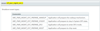

/**@brief Handler for shutdown preparation.
bool shutdown_handler(nrf_pwr_mgmt_evt_t event)
    uint32_t err_code;
    if (m_is_ready == false)
        m_sysoff_started = true;
        return false;
    switch (event)
        case NRF_PWR_MGMT_EVT_PREPARE_SYSOFF:
            NRF_LOG_INFO("NRF_PWR_MGMT_EVT_PREPARE_SYSOFF");
            /**@brief       Function for disabling all buttons.
             * @details     After calling this function, no buttons will generate events when pressed, and
             *              no buttons will be able to wake the system up from sleep mode.
             * @retval      NRF_SUCCESS              If the buttons were successfully disabled.
             * @retval      NRF_ERROR_NOT_SUPPORTED  If the board has no buttons or BSP_SIMPLE is defined.
             * @return      A propagated error.
            err_code = bsp_buttons_disable();
        case NRF_PWR_MGMT_EVT_PREPARE_WAKEUP:
            NRF_LOG_INFO("NRF_PWR_MGMT_EVT_PREPARE_WAKEUP");
            // Suppress NRF_ERROR_NOT_SUPPORTED return code.
            UNUSED_VARIABLE(err_code);
            /**@brief       Function for enabling wakeup from SYSTEM OFF for given button.
             * @details     After calling this function, button can be used to wake up the chip.
             *              This function should only be called immediately before going into sleep.
             * @param[in]   button_idx  Index of the button.
             * @retval      NRF_SUCCESS              If the button was successfully enabled.
             err_code = bsp_wakeup_button_enable(BTN_ID_WAKEUP);
            err_code = bsp_nfc_sleep_mode_prepare();
        case NRF_PWR_MGMT_EVT_PREPARE_DFU:
            NRF_LOG_ERROR("Entering DFU is not supported by this example.");
            APP_ERROR_HANDLER(NRF_ERROR_API_NOT_IMPLEMENTED);
        case NRF_PWR_MGMT_EVT_PREPARE_RESET:
            NRF_LOG_INFO("NRF_PWR_MGMT_EVT_PREPARE_RESET");
    err_code = app_timer_stop_all();
    return true;

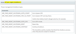

            if (m_sysoff_started && m_is_ready)
                /**@brief Function for shutting down the system.
                 * @param[in] shutdown_type     Type of operation.
                 * @details All callbacks will be executed prior to shutdown.
                 nrf_pwr_mgmt_shutdown(NRF_PWR_MGMT_SHUTDOWN_CONTINUE);
        // BSP_EVENT_SYSOFF = The device should enter system off mode (without wakeup)
        case BSP_EVENT_SYSOFF:
            m_stay_in_sysoff = true;
        // BSP_EVENT_SLEEP = The device should enter sleep mode
        case BSP_EVENT_SLEEP:
            if (m_stay_in_sysoff)
                nrf_pwr_mgmt_shutdown(NRF_PWR_MGMT_SHUTDOWN_STAY_IN_SYSOFF);
            else
                nrf_pwr_mgmt_shutdown(NRF_PWR_MGMT_SHUTDOWN_GOTO_SYSOFF);
        // BSP_EVENT_RESET = The device should reset
        case BSP_EVENT_RESET:
            nrf_pwr_mgmt_shutdown(NRF_PWR_MGMT_SHUTDOWN_RESET);

Q2) The PuTTY shows the message:
<info> pwr_mgmt: Shutdown request 0
<info> pwr_mgmt: Shutdown started. Type 0
<info> pwr_mgmt: SysOff handler 0x00003A85 => blocking
What does 0x00003A85 and blocking mean?
What does the 1st and 2nd 0 mean? I only found nrf_pwr_mgmt_shutdown_t shutdown_type and nrf_pwr_mgmt_evt_t   m_pwr_mgmt_evt has the following definition
Thanks in advance!
     * If the device is ready to enter to enter sleep/system OFF mode, return FALSE directly
     * Otherwise, decide case by case
     *      1) If shuntdown type is "prepare to stay in System OFF state", disable all buttons
     *      2) If shuntdown type is "prepare the wakeup mechanism", disable all buttons, and only enable the wake up button, and setup NFC tag as the wakeup source
     *      3) If shuntdown type is "prepare to enter DFU mode.", print a meesage in hyperterminal. Handle the SDK error if exists: API not implemented
     *      4) If shuntdown type is "Application will prepare to chip reset", print a meesage in hyperterminal.
     * Lastly, stop all timers.

        switch (event)
                /**@brief Function for setting up NFCT peripheral as wake-up source.
                 * This function must be called before going into System OFF mode.
                 * @note This function is only applicable if NFCT is used exclusively for wakeup.
                 *       If NFCT is used for a different purpose, this function cannot be used.
                 * @retval      NRF_SUCCESS     If NFCT peripheral was prepared successfully. Otherwise,
                 *                              a propagated error code is returned.
                // Handle the SDK errors: API not implemented
        /**@brief Function for stopping all running timers.
         * @retval     NRF_SUCCESS               If all timers were successfully stopped.
         * @retval     NRF_ERROR_INVALID_STATE   If the application timer module has not been initialized.
         * @retval     NRF_ERROR_NO_MEM          If the timer operations queue was full.
        return true;
                else

    // Check the nRF52 DK schematic diagram.
                else
