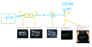

Does the 9160 GPS module have a built-in LNA?  Is it possible to adjust the GPS receiving sensitivity?
We hope that the wireless index of wearable products when worn on the hand can reach: the star value reaches 35-40dB.  How to solve the problem of slow star search speed caused by interference caused by wearing on the hand?
This is the circuit associated with our GPS signal reception
