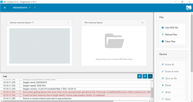

I'm trying to program a custom board with a nRF52810 via nRF Connect. I keep getting the following error messages:
Error when getting device info: Error: Error: Error occured when get device info. Errorcode: CouldNotCallFunction (0x9) Lowlevel error: NOT_AVAILABLE_BECAUSE_PROTECTION (ffffffa6)
20:06:57.641	Could not fetch memory size of target devkit: Cannot read property 'family' of undefined

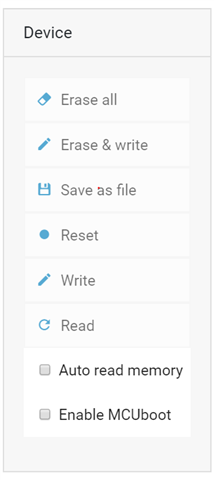

  • nRF Studio is no longer available. How could I erase the target with nRF Connect?
    The device options on the right are all disabled unless I'm connected to the target.
  • Ok, in nRF connect, you need to have the jlink connected and then the debugger connected to your custom board.
    On the top of the nRF connect window you'll be able to select the j-link, I think it will show the serial number or a bunch of numbers. After the debugger is selected, the options should be available.
  • This doesn't really work. When selecting the j-link debugger at the top, it tries to connect to the board but fails to do so. Thus the device control stays grey.
