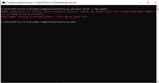

  • Hi ,
    now i get this error
    what to do?
    thanks
    Best Regards
    Fausto

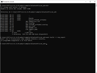

  • HI
    I execute the command :  build -t rom_report,  (in the build_crf52dk_nrf52832 directory and get this error:
    :\Users\PCF\ncs\v1.6.0\zephyr\samples\bluetooth\scan_adv\build_nrf52dk_nrf52832>west build -t rom_report
    -- west build: running target rom_report
    [0/17] Performing build step for 'mcuboot_subimage'
    ninja: no work to do.
    [2/15] Linking C executable zephyr\zephyr_prebuilt.elf
    FAILED: zephyr/zephyr_prebuilt.elf zephyr/zephyr_prebuilt.map
    cmd.exe /C "cd . && C:\Users\PCF\ncs\v1.6.0\toolchain\opt\bin\arm-none-eabi-gcc.exe @CMakeFiles\zephyr_prebuilt.rsp -o zephyr\zephyr_prebuilt.elf && cmd.exe /C "cd /D C:\Users\PCF\ncs\v1.6.0\zephyr\samples\bluetooth\scan_adv\build_nrf52dk_nrf52832\zephyr && C:\Users\PCF\ncs\v1.6.0\toolchain\opt\bin\cmake.exe -E echo ""
    c:/users/pcf/ncs/v1.6.0/toolchain/opt/bin/../lib/gcc/arm-none-eabi/9.2.1/../../../../arm-none-eabi/bin/ld.exe: zephyr\zephyr_prebuilt.elf section `text' will not fit in region `FLASH'
    c:/users/pcf/ncs/v1.6.0/toolchain/opt/bin/../lib/gcc/arm-none-eabi/9.2.1/../../../../arm-none-eabi/bin/ld.exe: region `FLASH' overflowed by 46088 bytes
    FATAL ERROR: command exited with status 1: 'C:\Users\PCF\ncs\v1.6.0\toolchain\opt\bin\cmake.EXE' --build 'C:\Users\PCF\ncs\v1.6.0\zephyr\samples\bluetooth\scan_adv\build_nrf52dk_nrf52832' --target rom_report
    C:\Users\PCF\ncs\v1.6.0\zephyr\samples\bluetooth\scan_adv\build_nrf52dk_nrf52832>
