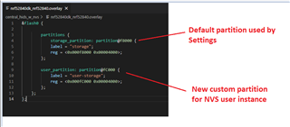

    Edit: have you defined a new flash partition for your NVS instance so there is not any conflict with the NVS instance used by Settings?
    e.g.
